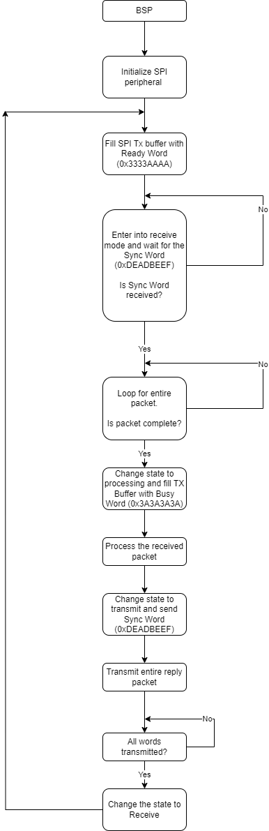

  7. SPI Protocol

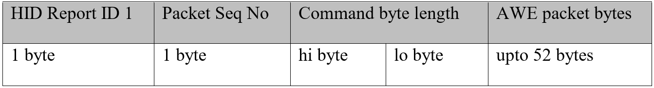

  8. USB Protocol

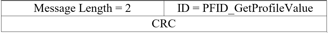

PFID_Undefined (ID = 0)
PFID does not exist.
PFID_SetCall (ID = 1)
Calls a module's set function.
Packet Format
Message Length = 4 coreID PFID_SetCall
uint instanceID
uint mask
uint CRC
Reply Format
Message Length = 3 0
int Error status
uint CRC
