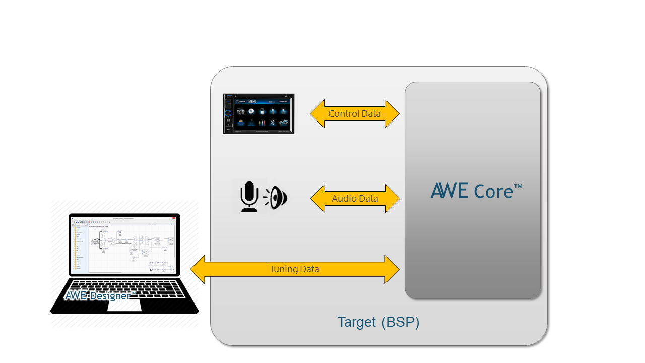

Data Interfaces
AWECore exchanges three types of data; Audio, Tuning, and Control.
Figure 1. The three data interfaces of AWE Core
Audio data Audio data is processed by the AWE Core signal processing component.
Tuning data is what dynamically configures the signal-processing, including the topology of the modules and the tuning parameters for each, such as filter coefficients or channel gain. This data is in the form of commands, typically issued by Audio Weaver Designer™ (or 3rd party tools / scripts).
Control data consists of parameters exchanged between firmware components and the Audio Weaver signal processing logic.

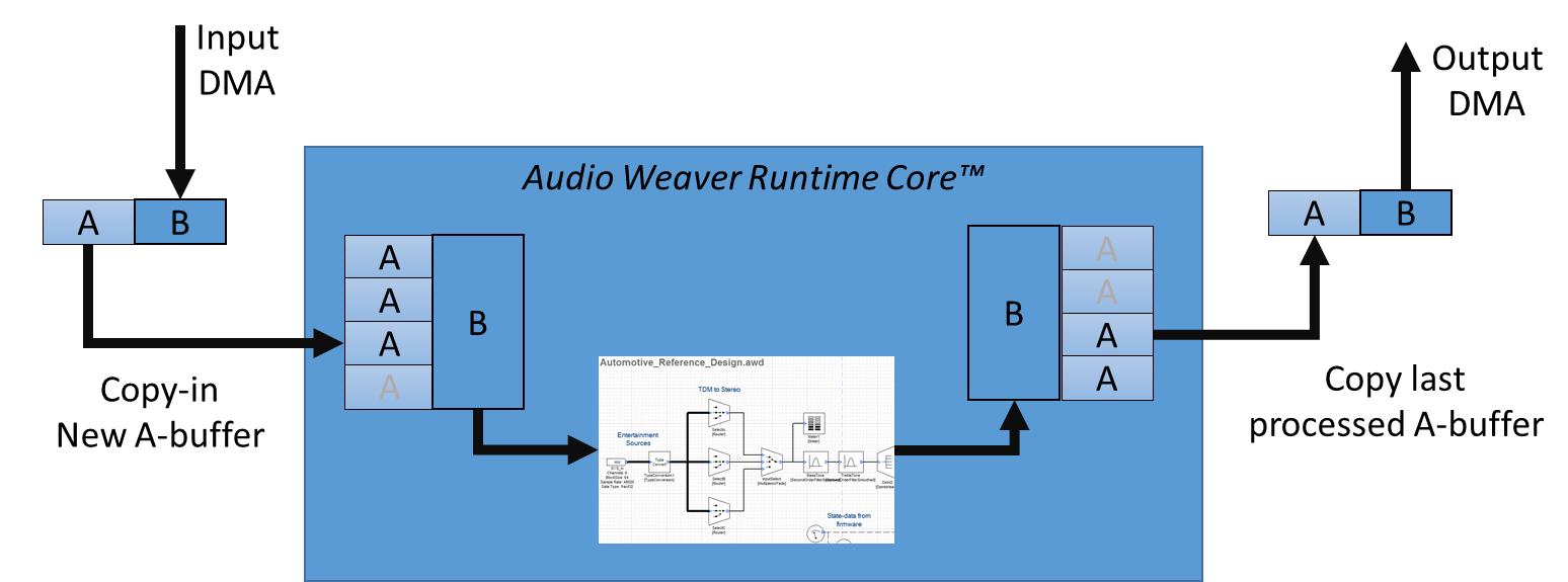

As audio samples are received, they are buffered into blocks. These blocks of audio samples are then copied into the AWECore subsystem, where they are processed.
A fundamental concept for AWECore is that the layout signal processing block size can differ from the DMA block size. For example, the firmware may be configured for a DMA block size of 32 samples, while a signal processing layout may use a block size of 64, 128, 256, etc. The one limitation is that the layout block size must be an integer multiple of the DMA block size. This decoupling allows the DSP engineer to easily make tradeoffs between MIPs, memory, and latency without having to modify or rebuild the target firmware. As shown in Figure 13, the AWE Core subsystem has internal buffering to automatically handle this decoupling. In the example in Figure 3, the signal processing layout operates on blocks 4x the DMA block-size.
Figure 3. Diagram of a static DMA-blocksize versus tunable processing-blocksize
The following steps illustrate the audio processing.
  1. When an audio frame is received it is copied from the DMA receive buffers to the input buffers of the AWE Core layout.
  2. Likewise, since input and output are synchronous, newly processed audio is copied from the AWE Core layout output buffers to the hardware output buffers.
  3. When the number of audio frames accumulated matches the number of audio frames needed, the layout is processed.
