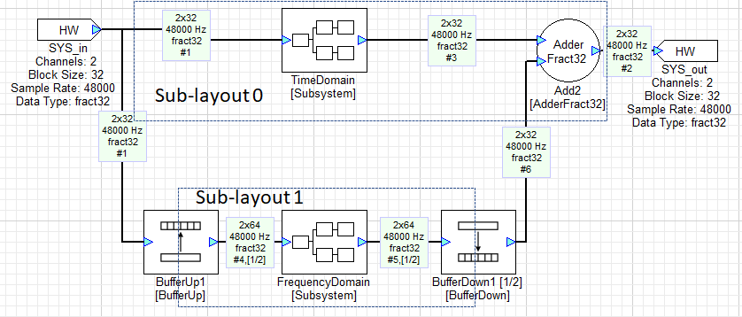

Multi-Rate Processing
The AWE Core allows audio to be processed at multiple block rates. For example, consider a system with two processing paths: one that processes time-domain data in blocks of 32 samples and another that processes frequency-domain data in blocks of 64 samples but at 1/2 the rate of the time-domain path. Such a system is shown in the figure below. It uses BufferUp and BufferDown modules to connect the different block size domains. These modules effectively partition the layout into 2 sub-layouts operating at different block rates.
Multi-Rate Layout
The two paths are executed at different rates and AWE Core’s awe_audioGetPumpMask() API call provides a mechanism to determine when the processing for each path should be initiated. Consider the following pseudocode:
layoutMask= awe_audioGetPumpMask(&g_AWEInstance);
if (layoutMask & 0x1) raise(AWEProcess_HiPrio);
if (layoutMask & 0x2) raise(AWEProcess_LowPrio);
AWEProcess_HiPrio()
    awe_audioPump(&g_AWEInstance, 0); // small block size path
AWEProcess_LowPrio()
    awe_audioPump(&g_AWEInstance, 1); // large block size path

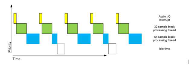

This code tests which sub-layouts have accumulated enough data to execute. The layoutMask variable contains a 1 in each bit position corresponding to sub-layout that is ready to execute. For example, if layouts 0 and 1 are ready to execute, layoutMask would be 0x00000003.
Lower numbered sub-layouts correspond to smaller block sizes. In the pseudo-code, a signal is raised for each sub-layout that is ready to be pumped.

Multi-Rate Scheduling
Real-time constraints dictate that if the 64 sample sub-layout is executed in the same context as the 32 sample sub-layout, both will need to complete processing before the next block of 32 samples arrives or real-time will be broken. This imposes an unnecessarily strict constraint on the 64 sample sub-layout – its processing need only be completed before the next block of 64 samples is accumulated. Thus, its processing time can, in principle, be spread over 2 of the 32 sample block times without breaking real-time. In practice, this is achieved by executing the two sub-layouts in separate contexts. The sub-layout with the shorter block size should have higher priority so that it can preempt the processing of the sub-layout with the longer block size. In this way, the real time constraints of each sub-layout can be accommodated. The following figure shows the timing for this example:
Multi-Rate Threading Model

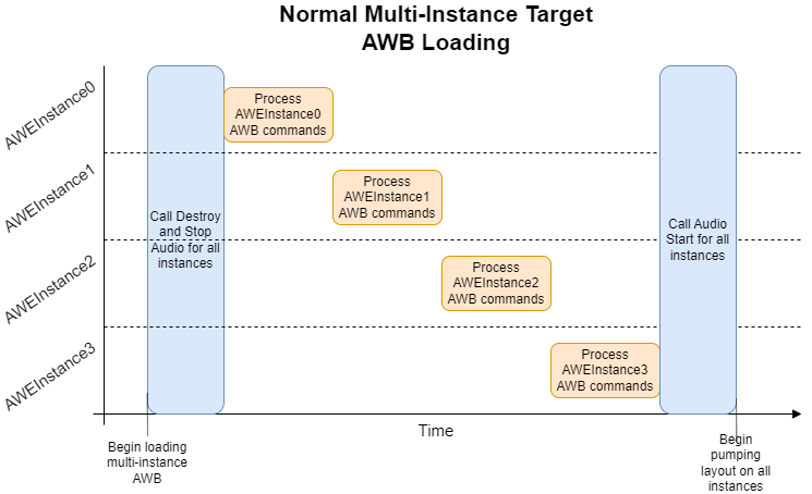

Normal Loading of Multi-Instance Layout
If the system has different boot time requirements for each instance (for example a 3 core system can have 2 cores with short boot time whereas the third core may have significantly higher boot time requirements), it's not possible to achieve these early audio requirements with a single AWB. To overcome this limitation, AWECore supports progressive loading of multiple AWB's one per instance on boot time. The AWE Core will ensure that audio remains synchronous between instances, even when loaded separately. Assigning AWE Instances as standalone only changes the timing of loading AWB’s directly on the target. The behavior of instantiating and tuning layouts over the tuning interface (like from Designer) is not changed. Following diagram shows the timing of progressive loading of multi-instance AWB.

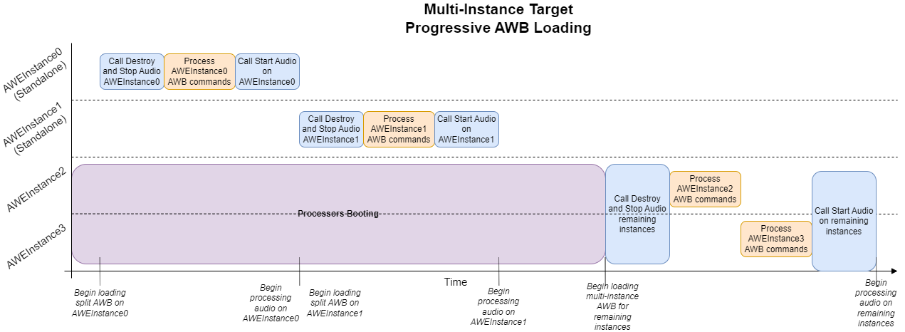

Progressive Loading of Multi-Instance Layout
Progressive loading can be applied to a multi-instance system with the following rules and constraints:
  1. A single multi-instance AWB must be split into a combination of standalone instance AWB's, where only a single instance has it's own AWB commands, and a single multi-instance AWB file with the AWB commands for the remaining non-standalone instances. All instances can be loaded standalone with individual AWB's, in which case there would be no remaining multi-instance AWB.
  2. If any instances are to be loaded in standalone mode, instance 0 must also be standalone.
  3. Standalone instances must all have a lower instanceId than the first instance included in a multi-instance AWB. That is, if instances 0 and 1 are loaded as standalone instances with individual AWB files, and instances 2 and 3 are loaded from a single multi-instance AWB, instance 4 can not also be standalone.
  4. To preserve synchronized and uninterrupted IPC, progressive loading of standalone instances must be done in sequential order of InstanceID's, beginning with instance 0, and continuing with instance 1 only when instance 0 is complete, and so on. Loading of a multi-instance AWB, if there is one, must only be done after loading all standalone instances.
  5. It is valid to not have any AWB's defined for any instances other than instance 0. That is, loading a standalone AWB on instance 0, and then a multi-instance AWB that targets only instances 2 and 3 is valid.
Splitting a multi-instance AWB into multiple AWB's to support progressive loading should never be done manually. In order to preserve synchronicity between instances, splitting a multi-instance AWB or AWS must be done using the MATLAB script split_multi_instance_layout, provided as part of Designer installs. Type help split_multi_instance_layout in MATLAB for usage information.
To enable progressive loading, call awe_setInstanceStandaloneAWBLoad() with the second argument as 1 (True) on instance 0 before loading AWB on instance 0 in standalone mode. On the remaining instances it depends on the split. If the split is into 2 AWB's, the remaining AWB can be loaded as normal from the tuning master instance. If the split is separate AWB per instance, then awe_setInstanceStandaloneAWBLoad() must be called in each instance before calling AWB loading API.

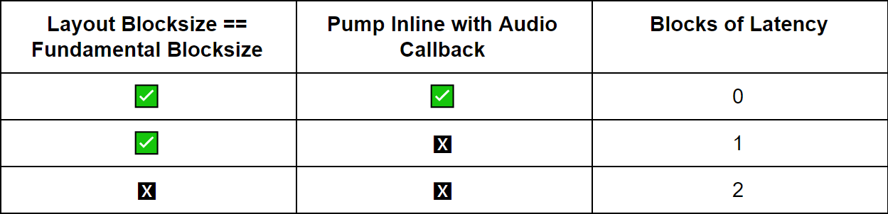

Conditions that Impact Latency
To achieve 0 blocks of AWE-induced latency, the following three conditions must be met:
  1. Equivalent Block Sizes: The loaded layout’s blocksize must be equivalent to the AWECore instance’s fundamental blocksize.
  2. Order of audio API calls: The order of AWECore audio processing API calls in the BSP’s audio callback must be import -> pump -> export, as in the following: awe_audioImportSamples() -> awe_audioGetPumpMask() && awe_audioPump() -> awe_audioExportSamples
  3. awe_audioPump() Inline with DMA callback: The awe_audioPump() API for layout index 0 must be called inline with the BSP’s audio callback, as opposed to signaling another thread or raising an interrupt.
latency-table

Pump Inline with Callback – Pump Context
Virtually all systems that integrate the AWE Core will use a thread signaling or interrupt raising scheme to trigger awe_audioPump in separate, lower priority contexts from the main DMA audio callback. While this scheme is required in order to allow for efficient, multi-rate operation of signal processing layouts, it does mean that the processing of the audio signal will not be complete by the end of the audio callback, As mentioned in the section above, a system with 0 blocks of AWECore induced latency must complete all audio processing within the context of the main DMA audio callback. So in order to achieve minimal latency, the first sublayout (layout index 0) must be executed in place during the audio callback, not in a lower priority context.
The first sublayout consumes the input pin and fills the output pin, so it is only this layout that needs to be processed in place. Other non low latency paths (clockdivided sublayouts, layout index > 0) should still be signaled by the callback and pumped in another context.
