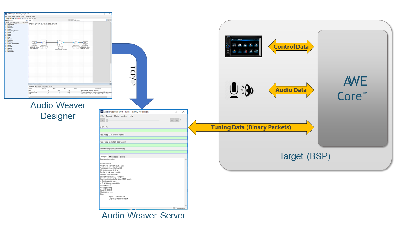

When using AWE Designer to create and tune a signal processing layout, tuning commands (and the resulting replies) are exchanged between the PC and the AWE Core OS running on the target hardware. The full path that these tuning commands travel is shown below.
Figure 2. Overview of Design-time Tuning Path
Communication between Designer and Server uses plain text commands. AWE Server then converts each text command into a binary packet and sends it to the target platform over the specified tuning transport (e.g. Ethernet, USB, RS232, etc.). Scripts containing the text commands are called Audio Weaver Scripts (AWS). Scripts containing the binary commands are called Audio Weaver Binary (AWB) scripts.
For a more detailed description of our Tuning Protocol and the AWB command structure, please see the Tuning Protocol document here. Also review the built-in TCP/IP based tuning interface here: aweOS_tuningSocketOpen
Note that this command protocol is strictly initiated by the host (typically AWE Server). The host issues a command and will not issue another command until the original command is complete or times out. The firmware can never issue a command. It can only respond with a single reply to the current command.
