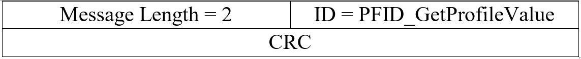

Message Structure
Audio Weaver Tuning commands and replies use 32-bit words, with a 1 word header and 1 word CRC wrapping the payload.
The length of the packet includes the header and CRC word. Thus, the shortest possible message – one without a payload – is two words in length.
32 bit word (header)
32 bit word (CRC)
TX Packet Structure See the table below for the command structure. Note that the header is divided into three sections, 16 bits for the command length, 8 for instanceID, and 8 for opcode.
16 bit length 8 bit instanceID 8 bit opcode
PAYLOAD[0]
PAYLOAD[1]
PAYLOAD[N-1]
CRC WORD

PFID_GetProfileValues (ID = 43)
Returns overall MIPs profiling information for a layout.
averageCycles is the average number of profiling cycles required to process the entire layout. This is measured in real-time and averaged over approximately 100 executions of the layout. timePerProcess is the amount of time between calls to the layout processing function. This indicates how much total processing is available in the system. Optionally specify a layout index to get a specific layout's profile statistics.
Packet Format (Option 1 - All Layouts)
Message Length = 2 coreID PFID_GetProfileValue
uint CRC
Packet Format (Option 2 - Specific Layout)
Message Length = 3 coreID PFID_GetProfileValue
int layout index
uint CRC
Packet Format (Option 3 - All Layouts)
Passing -1 as the layout index will get the same response as Option 1.
int layout index == -1
uint CRC
Reply Format
Message Length = 5 0
int error status
uint averageCycles
uint timePerProcess
uint CRC

For example, consider the command PFID_GetProfileValues with ID = 43. The message sent from the PC to the target processor is:
GetProfileValues Message Example
Which translates into the 32-bit words:
0x0002002b
0x0002002b  (CRC is the same for 1 word payloads)
The 32-bit words are expanded into 5 bytes each:
0x0002002b -> 0xAB 0x80 0x88 0x80 0x80
Adding the remaining protocol bytes, the sequence sent is:
0x02    (start byte)
0x3X    (sequence)
0xAB 0x80 0x88 0x80 0x80 (payload)
0xAB 0x80 0x88 0x80 0x80 (CRC)
0x03

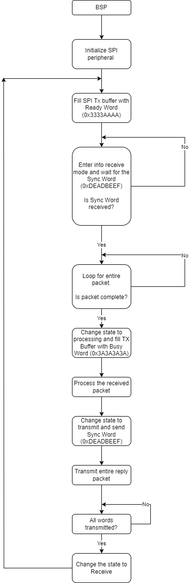

To communicate to the server that the target is ready to receive a message, the entire SPI output buffer must be set to the "ready" word 0x3333AAAA. After a message is received by the target processor and the message is being processed, the entire SPI output buffer will be set to the “not ready” word 0xA3A3A3A3. This will allow a host processor to poll the SPI interface waiting for the target processor to complete message processing. The target processor will continue to transmit the not ready word until the message has been processed. At this point, it will switch over to the "sync" word 0xDEADBEEF followed by the complete message. Once the entire message has been sent, the SPI output buffer must be set to the "ready" word again. See the diagram below for how to implement a SPI based tuning interface:
SPI State Diagram
If the host processor continues to read beyond the end of a reply from the target, then the target will return 0xFFFFFFFF or the last transmitted word, which could be the "ready" word depending on the SPI peripheral configuration.
