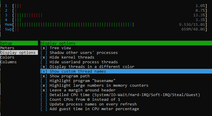

Note: if htop is not showing the names listed above, go to Setup (F2) -> Display Options and enable "Show custom thread names" as seen below. Enabling the Tree view display option is also helpful.
htop Thread Names
