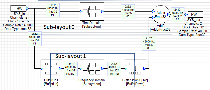

The AWE Core allows audio to be processed at multiple block rates. For example, consider a system with two processing paths: one that processes time-domain data in blocks of 32 samples and another that processes frequency-domain data in blocks of 64 samples but at 1/2 the rate of the time-domain path. Such a system is shown in the figure below. It uses BufferUp and BufferDown modules to connect the different block size domains. These modules effectively partition the layout into 2 sub-layouts operating at different block rates.
The two paths are executed at different rates and AWE Core’s awe_audioGetPumpMask() API call provides a mechanism to determine when the processing for each path should be initiated. Consider the following pseudocode:
layoutMask= awe_audioGetPumpMask(&g_AWEInstance);
if (layoutMask & 0x1) raise(AWEProcess_HiPrio);
if (layoutMask & 0x2) raise(AWEProcess_LowPrio);
AWEProcess_HiPrio()
awe_audioPump(&g_AWEInstance, 0); // small block size path
AWEProcess_LowPrio()
awe_audioPump(&g_AWEInstance, 1); // large block size path

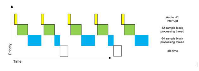

This code tests which sub-layouts have accumulated enough data to execute. The layoutMask variable contains a 1 in each bit position corresponding to sub-layout that is ready to execute. For example, if layouts 0 and 1 are ready to execute, layoutMask would be 0x00000003.
Lower numbered sub-layouts correspond to smaller block sizes. In the pseudo-code, a signal is raised for each sub-layout that is ready to be pumped.
Profiling designs on high-level OSes is challenging because layout threads may run on any available core at any given time. An OS-level mechanism to lock a particular thread to a certain core may be available. If so, one can notify AWECore that a layout thread will run on a specific core, and more accurate profiling will be shown in AWE Server. These functions are awe_fwSetLayoutCoreAffinity() and awe_fwGetLayoutCoreAffinity(). By default, all layouts are assumed to run on core 0.
Real-time constraints dictate that if the 64 sample sub-layout is executed in the same context as the 32 sample sub-layout, both will need to complete processing before the next block of 32 samples arrives or real-time will be broken. This imposes an unnecessarily strict constraint on the 64 sample sub-layout – its processing need only be completed before the next block of 64 samples is accumulated. Thus, its processing time can, in principle, be spread over 2 of the 32 sample block times without breaking real-time. In practice, this is achieved by executing the two sub-layouts in separate contexts. The sub-layout with the shorter block size should have higher priority so that it can preempt the processing of the sub-layout with the longer block size. In this way, the real time constraints of each sub-layout can be accommodated. The following figure shows the timing for this example:

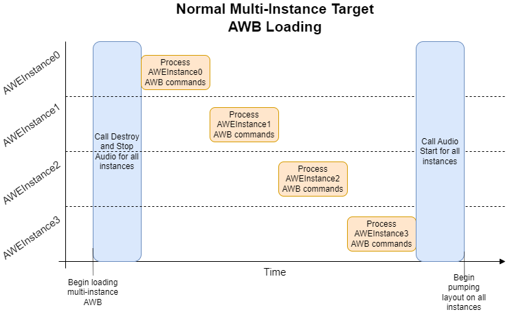

In the multi-instance systems the signal flow for all instances is contained in a single AWD layout file. The AWE Core framework loads the entire AWB so that all instances load their respective layouts before calling PFID_StartAudio, which signals the system to start processing the layout. This strategy of loading all the layouts for every instance before starting processing guarantees initial synchronicity between all the AWE Instances. The diagram below shows the timing of normal loading an AWB for a Multi-Instance system.

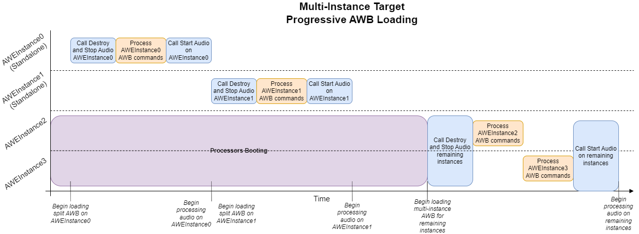

If the system has different boot time requirements for each instance (for example a 3 core system can have 2 cores with short boot time whereas the third core may have significantly higher boot time requirements), it's not possible to achieve these early audio requirements with a single AWB. To overcome this limitation, AWECore supports progressive loading of multiple AWB's one per instance on boot time. The AWE Core will ensure that audio remains synchronous between instances, even when loaded separately. Assigning AWE Instances as standalone only changes the timing of loading AWB’s directly on the target. The behavior of instantiating and tuning layouts over the tuning interface (like from Designer) is not changed. Following diagram shows the timing of progressive loading of multi-instance AWB.
Progressive loading can be applied to a multi-instance system with the following rules and constraints:
Splitting a multi-instance AWB into multiple AWB's to support progressive loading should never be done manually. In order to preserve synchronicity between instances, splitting a multi-instance AWB or AWS must be done using the MATLAB script split_multi_instance_layout, provided as part of Designer installs. Type help split_multi_instance_layout in MATLAB for usage information.
To enable progressive loading, call awe_setInstanceStandaloneAWBLoad() with the second argument as 1 (True) on instance 0 before loading AWB on instance 0 in standalone mode. On the remaining instances it depends on the split. If the split is into 2 AWB's, the remaining AWB can be loaded as normal from the tuning master instance. If the split is separate AWB per instance, then awe_setInstanceStandaloneAWBLoad() must be called in each instance before calling AWB loading API.
INT32 awe_setInstanceStandaloneAWBLoad(AWEInstance* pAWE, INT32 status);
NOTE:
**When progressive loading is enabled, awe_audioIsReadyToPumpMulti() must be called for all secondary instances, before calling awe_audioGetPumpMask() in instance 0.**
In progressive loading, the AWB loading APIs awe_loadAWBfromArray() and awe_loadAWBfromFile() and awe_loadAWBfromFlash() return error code E_MULTI_INSTANCE_SPLIT_AWB_NOT_STARTED (-119) when trying to load AWB in an instance but the previous instance is not yet started (see constraint 4 above). For example, when trying to load AWB on instance(s) > 0, but instance 0 has not finished loading its AWB, the awe_load* APIs will return E_MULTI_INSTANCE_SPLIT_AWB_NOT_STARTED. This error code is provided to help users synchronize sequential AWB loading across multiple instances. Users should check for this error code and try to load the AWB in a loop until success or different error code.
Following are some of the example use cases with 3 instances system where instance 0 is the audio master and instance 2 is a tuning master.
Case 1.
-> Split the 3 instances AWB into 3 parts, Inst0_AWB, Inst1_AWB and Inst2_AWB.
-> On instance 0,
awe_setInstanceStandaloneAWBLoad(&g_AWEInstance, 1); // Mandatory ret = awe_loadAWBfromArray(&g_AWEInstance, Inst0_AWB, Inst0_AWB_Len, &pos);
-> On instance 1,
while(1) { ret = awe_loadAWBfromArray(&g_AWEInstance, Inst1_AWB, Inst1_AWB_Len, &pos);
// If the previous instance not started, awe_loadAWBfromArray() returns E_MULTI_INSTANCE_SPLIT_AWB_NOT_STARTED error code. Call AWB loading function in a loop until error code is not E_MULTI_INSTANCE_SPLIT_AWB_NOT_STARTED. if (ret != E_MULTI_INSTANCE_SPLIT_AWB_NOT_STARTED) { break; } }
-> On instance 2 (tuning master), AWB can be loaded in standalone or regular AWB.
awe_setInstanceStandaloneAWBLoad(&g_AWEInstance, 1); // Optional
while(1) { ret = awe_loadAWBfromArray(&g_AWEInstance, Inst2_AWB, Inst2_AWB_Len, &pos);
Case 2.
-> Split the 3 instances AWB into 2 parts, Inst0_AWB and Inst1_2_AWB.
-> On instance 0,
-> On instance 1, no changes.
-> On instance 2 (tuning master), combined AWB for instance 1 and 2 must be loaded as regular AWB.
while(1) { ret = awe_loadAWBfromArray(&g_AWEInstance, Inst1_2_AWB, Inst1_2_AWB_Len, &pos);
